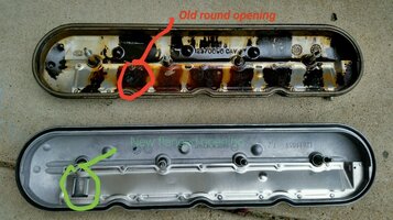

Have changed after cleaning one PCVValve cover, added oil catch cans (upr products) to both sides of the vent, been cleaning the fouled spark plug, replaced cylinder 4 injector once, changed the purge canister, the purge valve, p0449 and vapor canister p0446, got the camshaft actuator replaced and p0011 gone.

I was filling the catch in fifty miles before, now the catch cans barely catch any, but the throttle body saw enough to lose it sensors….

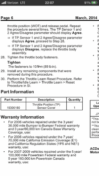

Do i buy a reman throttle body 200 +\- or get the rebuild kit ($140 back cover only) from Gm like the TSB?

Because i was having the misfire on cyl 4 the problem magnified on the passenger side, which vents into the fresh air before the throttle body…so i added another, hard to see, lower left below the battery and large AC line.
Now both cans have a couple drops, but it needs the splash guard afm shield on the oil relief valve still.

I wasn't aware of a TB rebuild kit. Before I would go either route, I'd try a used one, probably from a pick-n-pull if you have one.
P2135 point to a throttle/pedal position sensor/switch A/B voltage correlation. There are many possible causes which may not be an issue with the TB.
Potential Causes of P2135 DTC
It's been my experience that the wiring connector or "pig tail" on the throttle body gives problems in the form of a poor connection.The female terminals on the pigtail corrode or pull out of the connector. Possible bare wire on pigtail shorting to ground. The top cover on the throttle body distorted preventing the gears from turning properly. The electronic throttle body is faulty. The accelerator pedal sensor or its wiring failed. The engine management computer has failed. The TPS sensors were not correlating for a few seconds and the computer needs to be cycled through its relearn phase to restore active response to the throttle body, or the computer needs reprogramming at the dealer.
Read more at: https://www.obd-codes.com/p2135
Copyright OBD-Codes.com
The last is a possibility if either the TB or the pedal sensor has been replaced or the TB has been cleaned, requiring a TB relearn.

The oil consumption can be a bad PCV valve built into the drivers side valve cover. Seen this a couple times, and had this problem on my Saab. Try replacing the valve cover with NEW.
Edit: If you have not pulled the intake off, there could be a pool, yes a literal pool, of oil in the lower sections of the intake. And as you brake, and throttle, the oil will go into the rear most, and front most, intake runners. Will produce smoke that smells absolutely horrid.. At least it did for me.
How much oil in the catch cans? If you are seeing minimal amounts and compression is OK then worn valve stem seals might be the culprit.

I didnt have a aftermarket catch can, so my intake manifold was my catch can...
I would say when I did the #1 lifters last year, there was likely a quart in there.
