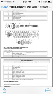

Hello all, my 05 Envoy transfer case would not shift, tried a new encoder motor, same thing, binding.
Have it on the bench, trying to remove the output shaft to have a look at the shift mech,
cant seem to figure how to get it out, any help appreciated.

I have this manual for the transfer case. Hope it helps. Most of the time, when we have problems with them, we just grab a junk yard unit.

Buddy brought puller over, pressure plate bearing part#12 dissolved .
Should be able to get this going againImageUploadedByTapatalk1444352932.436322.jpgImageUploadedByTapatalk1444352974.273469.jpgImageUploadedByTapatalk1444352997.368270.jpgImageUploadedByTapatalk1444353022.430759.jpgImageUploadedByTapatalk1444353037.938274.jpgImageUploadedByTapatalk1444353048.977547.jpg

Just out of curiosity, how was the maintenance on it prior to the meltdown? Was the fluid changed every 50K miles?
turbottime
Sep 29, 2015
9
Poorly maintained, bought this awhile ago , needed a lot of repairs. I don't think the tc fluid had ever been changed, came out pure black, probably caused that bearing to fail.
Has 150000 hard miles on it

Update, back together for a few weeks, working good, replaced parts 11,12,13
Thought I would post a pic of a easy tool to make to install the speed sensor gear.Just a piece of exhaust tubing, plate with a 1/4" hole in it, piece of 1/4-20 unc threaded rod and nut.
