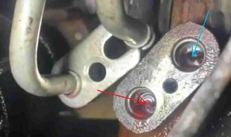

The closest images I can find that emulate an "X-RayProfile" image of the Manifold Inlet and Outlet Ports are shown among these below and it appears to have "Standard Openings" for Fluid Flow Uniformity:

The closest images I can find that emulate an "X-Ray" of the Manifold Inlet and Outlet Ports are shown below and they appear to have "Standard Openings" for Fluid Flow Uniformity:
View attachment 109781View attachment 109782View attachment 109783
Thanks. The pic I was referring to were the ones you sent from the video. It's at the 3:42 mark and through the red fluid it looks like what I see in my inlet port: some sort of valve that appears to open under the fluid pressure?

If you mean the differences between what the Red Arrow (Pressure Side?) and the Blue Arrow (Return Side?) are pointing at... I can only speculate that in order to prevent "Fluid Jacking" harmonics from jamming up the Power Steering Pump Export Pressure side because "all liquids are incompressible" and thus, Unregulated Hydraulic Pulsations can literally ...Hammer Pumps To Pieces... Or perhaps equally important, to prevent any Air Cavitation when the Engine is not running due to Gravity Line Fluid Bleed Downs... so they may have added a One Way Poppet Style Check Valve. If presently disassembled, you might take a Close Up Image in High Definition and compare these two in appearance:

Yes. That valve is what I'm referring to. This is my rack pic. That's by design, correct?

Yup... even by a cursory visual comparison... You can see that they are a "DBOM". Take notice of the Off-Set for the Threaded Plate Hold Down Fastener which means that there is ONLY ONE WAY to install the Line and prevent the accidental reversal of Proper Power Steering Fluid Flow.
