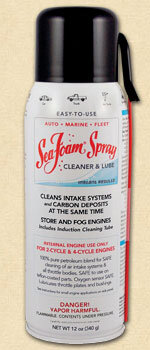

Sorry typo....TUBE.
Get that, then run it through by spraying it in before the TB. The tube is flexy so you can insert it between the intake line and the silencer (the big plastic thing with Vortec 4200 on it).
Make sure you put your line in after the MAF if you have one, as I don't believe Seafoam is safe for them.

Almost forgot bout the spray vs brake boost part... I read on the os that some said both were ok...

If you look where the brake booster line connects to the intake manifold, you'll see that using the brake booster method will get the front cylinders, but most likely not the rears.
You won't hurt anything, but won't effectively clean everything either. Spraying into the throttle body ensures a much more even distribution.

i have a case of cans... maybe i'll see if i can get a case of those to... i dont have a silencer i have the loudener... and thanks for the info. i have been doing them at some midwest meets through the brake booster. and man did they smoke :eek:
