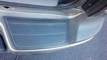

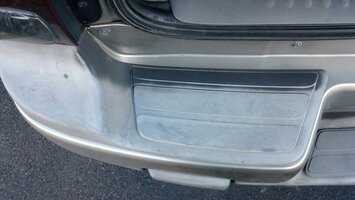

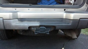

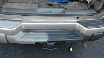

Took a heat gun to my bumpers to bring them back to black heres some pics...
Easy to do and makes a huge difference

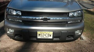

Heres a before pic of the front

Wow. What a difference. Nice job! I gotta do mine as soon as the weather improves.
Boricua SS
Nov 20, 2011
3,080
Ohio
amazing what a little heat can do :rotfl:
looks good :thumbsup:

That looks better than most trim restore compounds that I have used. Plus you do not have to worry about it washing/wearing off.

Thanks everyone. Yea, it is easy just time consuming. Some spots are hard to get to with a heat gun also.
