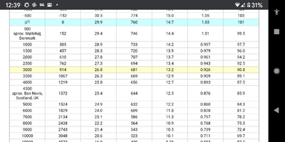

hmmmm.... you might want to do the key on, engine off obd vacuum reading a few times over the next few days or hours. That seems like a significant difference on the "baro". You can pull your filter for a "short while" to see if it makes any immediate difference on the air flow readings... maybe.

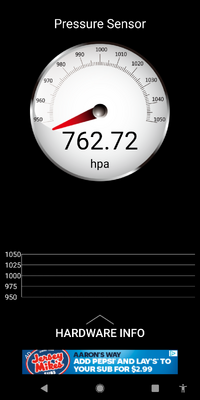

You can also install any of dozens of free smartphone apps that display the sensor data from your phone and can quickly see current barometric pressure to compare to your MAF/MAP sensor KOEO reading. Pressure data is generally reported as millibars or hPa so the conversions are straightforward.

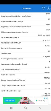

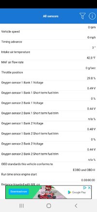

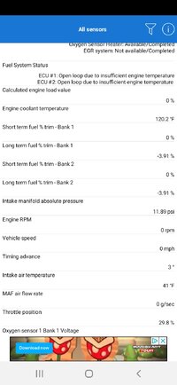

Key on and engine off baro was 82kpa, map 11.89 psi, and no vacuum on torque.

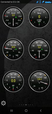

So I redid my wire fix job on my map and temp sensor as they were rush frustrated jobs. I took it to the store today because I haven't driven it in a while and no more pending p0172 and p0175. They were pending on thanksgiving after car work and I haven't touched or driven it till today. I doubt it's fixed but just found that interesting and quietly hoping. And also yes I can soon on the trim numbers
I'm pretty solid on it being my throttle body. I had a bad from my wife's 6.0 tahoe that I slipped my harness onto and my tps would drop down and then slip it back on mine and it would pin to the 30%. If my thought process is right even once now couldn't my throttle body be bad and its telling the ecu it's under load so it's putting in more fuel than necessary so creating the rich condition?
I don't think so.... This is "key on, engine off" data. I think that the tb has a "relaxed" position and an enerigized position (ie. running). You can readily confirm by looking at the data at idle. You should see the tb sitting at in and around 20 for a "normal" idle. IF that is not the case, then perhaps you do have a TPS issue.

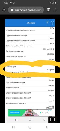

As for the fuel level, are you saying your tank is empty, half full, full and that indicator is not correct?

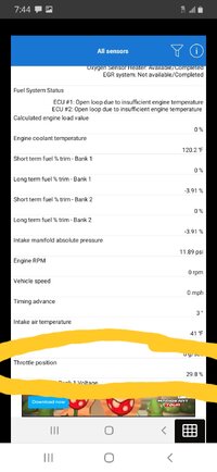

So it was the 29.8 at idle with the old throttle body and with
So with the old one it was 29.8 at idle, the spare one drops below 20. I just checked with key on and engine off and it sits at 30. I am going to compare it to the tahoe just for reference.
No I was confused on the fuel level input on if it meant that was the fuel it was putting into the motor. Also going to compare it to the tahoe. I know they are different platforms but at least for some sort of reference

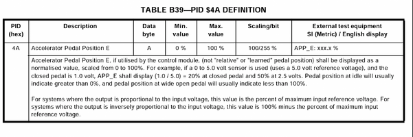

On difference I really see between the 2 is "absolute pedal position d and e" both mine are 20% and the tahoe is d 19% and e 9%. I can not for the life of me find what these are, I google it and it brings up throttle position sensor so I'm hoping it's that but I don't know. My engine load is also 4% higher but I don't think to much of that. Anyone know what the "absolute pedal position E" is?
I can't make sense of your posts which seem to be "broken up" a bit.
The post that you have attachments for and show the throttle position circled is not "at idle" but is just a key on. You seemed to then indicate that this was the "old one" at idle... ???? It is not IF that is the data attachment that you posted... the rpm on the engine is "0"... engine is not running.
Please confirm what you are seeing / doing.
I got a new phone so I lost all my data logs from car scanner, that was the last log i posted on this thread before that. I must have over looked the rpms because I'm grasping for straws here because I'm at such a loss. I do apologize for overlooking that. Do you have any idea what that absolute pedal E is? The only other thing I can even think to compare the two cars on is vacuum to see if there is much difference.
I don't lnow what absolute pedal e is for. Not sure it matters. BUT you are indeed "wandering". There were things that were suggested herein both by you and others... an example, you mentioned about pulling a vacuum line and seeing if your "claim" about it changing trims was accurate and also if it was seen (ie. vacuum value changed in step). Was that done? what was the result?

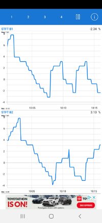

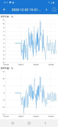

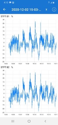

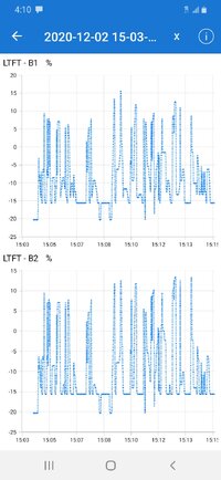

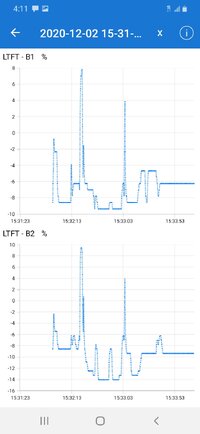

First two are with a vacuum line pulled and last two are some driving. I noticed that it only seems to be bad at idle. When I'm driving all my numbers go way closer to 0 but I so much as slow down for a stop light and they tank negative fast, especially when I put it into park.
OK... that is a good basis for understanding what happens with a vacuum line pull and as expected ("extra air") so the system seems to respond there in. Idle will be most impacted as the extra air will cause richness which will cause running slow a problem.
Now you need to provide exactly the same type of data for a run with everything plugged together with little to no leaks (as far as you can determine). Then you can compare data to determine what your next step might be. I am somewhat concerned about the variance of the LTFT... I would expect them to be more like the end of the second chart somewhat "flat" / stable. Were you pounding on the pedal on the front part of the second set of chart (ltft).... even opening and closing the throttle plate / pedal?
