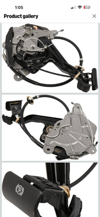

Hello everyone, running into a bit of an issue with my '03 Silverado 1500. I replaced my rear parking brake cables and my intermediate cable, but when I go to connect the two, there is too much tension on the front cable causing about 2 inches distance between the bracket and the intermediate cable bolt. My truck specifically uses rear discs and the gm 25780186 parking break pedal. I read online that the pedal mechanism is self adjusting via a ratcheting system and that's why I'm running into this issue. However, I have zero idea on how to unlock the ratchet in order to make slack. Any help would be appreciated

That does lead me in the right direction, however I have a much different parking break system than that

I did, and after messing with it today, I figured out that the slack was in the ratchet, and you're supposed to pin the ratchet and pull the front cable towards the back of the truck. However, even when pinning the ratchet, I cannot pull the slack towards the rear.

Other than that, maybe you got the "right" cable but the cable inside is a little short. Did you loosen the cable splitter adjuster? Might also have to loosen the adjustment of the shoes. IIRC, there isn't an adjustment on the rear cables themselves.
