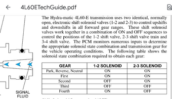

Maybe someone who know transmissions better than I (which is likely anyone) can comment here, but looking at this would a 2-3 solenoid failure result in having only third and fourth gears and a 1-2 solenoid failure would result in having only second and third gears?
