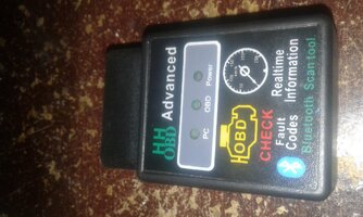

One thing you should get is a Bluetooth ELM327 OBD interface and get the Android app Torque. It can give you live data, including misfire counts, as well as error codes. Way better than a simple code reader. I have this one and works well.
https://www.amazon.com/dp/B019SURWYO/?tag=gmtnation-20

I took it for test drive after clearing the code with my bluetooth scanner,
and drove around to see how bad misfire/skip was. Ran like crap, check engine light came on then went off with no change, when I parked it, the code hasn't come back yet but still ran like crap. Im sure code will be back today.
