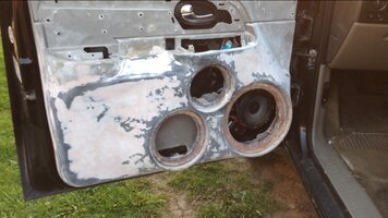

Yup, the handle to recline the seat to be exact, see i measured the distance from the face of the door panel to the top of the flush ring to be 2" and that gave me 1/2" of clearance between that handle and the ring... Well the ring is made in 2 parts both of witch is 3/4" MDF... So a total of 1 and a half inches, so i needed a 1/2" stilt to mount the ring to... Well i didnt write my measurements down and ended up only remembering the number 2" so i cut the stilt 2" and that was ALL BAD! And to make it worse my dumbass never test fit it after the mockup stage,[emoji33] which would have let me correct the mistake right then and there, well needless to say i didnt make that mistake this time
Got some more work done today after work, got 4 layers of resin layed, tomorrow ill be laying a couple layers of fiberglass chop mat on them, then they will be ready for sanding and finish work, should be finished and ready for vinyl by saturday, but i will test fit and do some listening/tuning all next week, probably wont actually vinyl them till next weekend or possibly the following weekend.
:undecided: So lemme see if I get the general idea here. Get your frame situated the way you want it, then stretch that fleece material over it and secure it so it more or less has the contours you want. Soak it with FG resin so it becomes solid when it dries and holds the shape, then build it up with chopped mat and more resin for strength. Apply the preferred finish finish, paint/carpet/vinyl, and then enjoy? :book:
Bingo my friend! And get a jasper jig for the router, plus a quarter inch spiral up cut bit to cut the rings
I been BUSY today on my day off, got the drivers door done and ready for vinyl, finishing the pass door tomorrow

Got the fronts all test fitted, the innevitable happened and i have to do some braceing, with the shear weight of the doorpanel it drops half an inch or so, so im gonna make some braces and lift it back up this week... What ya guys think
:confused: The whole door sags? Damn son, how the hell do you get bracing in place for that?
Well ya gotta be smart enough to plan ahead for it, i am gonna remove the 6" use some aluminum stock(wont rust incase of water) use some stainless steal bolts and locking nuts and make some straps bolted to the map pocket and use them as hangers and left the door back up in place, i believe the front door panels weigh about 45 lbs with all speakers in!
Oh, so the door panel is what's sagging... I thought you meant the door hinges weren't holding the door up, and it was coming out of alignment due to the weight of all that hardware :crazy:

Well got the front doorpanel brackets all made up and installed, much better now, i swapped days off with a coworker who needed friday off so i am planning on Takeing a break from the truck tomorrow and doing some much needed yard manicuring, so heres a lil more audio porn... Lol
