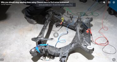

Some NVH Tools that may help pinpoint the Random Vibration problem(s) with minimal invasive labor:
