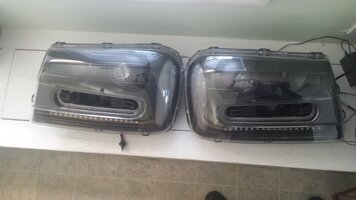

Got my headlight bezels scuffed up. Should have them primed and ready for paint possibly tomorrow. Then I'll start modifying the reflector bowls and getting them ready for the H1s and Mini Gatling shrouds.
Reactions: Sib and Mounce
So I gave them a quick sand, primered and painted them. Hard to tell but it's Dark Grey Metallic. If anything maybe it will keep them from getting light gray. Next will be the reflector bowls.
A small update, painted the reflector housing after sanding down the inside to get the projector mounted. I'm working in the shrouds and clear corners next. Hopefully will have them ready in a few days.
