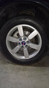

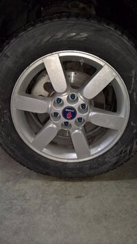

I have the same TB 17s on my Saab for winter tires I got Firestone Winterforce tires though. Debating if I want to paint or plastidip them black. What do you guys think?
Well the Delivery date was WAY off. Just got the emblems today. Took about 20 minutes to wash dry apply and pop the center caps back on. Here's some pics (ignore the mud clods)... enjoy!

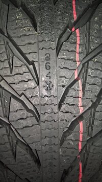

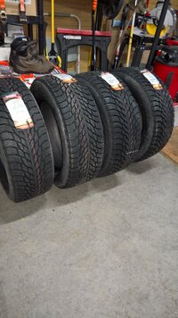

I upgraded this winter to some REAL 18" Saab wheels and sold the 17s pictured above.. plus some new Nokian R3s

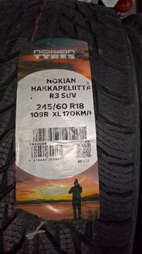

Older thread.. But I have not even had my 9-7x for a year yet..
That said, the stock tires are stupid expensive 255/55/r18.. BUT..
If you go to tire size..
235/60R18
Your speedo will only be 0.2% off, and the tires are around half the price, with more options.
Stock size compared to new size...
Yes, the tires are about 1 inch narrower, but fit, and work. Have not noticed a ride difference at all.

The 245/60/18 were my choice.. and I changed the tire size in the computer so they are accurate.
Reactions: Beacon
I tried to find that size locally, everything is on back order, with no ETA for delivery.. Had to go to the next best thing.
