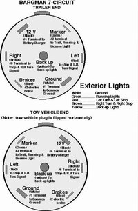

I tapped into the trailer wiring for my LED license plate holder. I can ty-wrap the holder anywhere not on the hatch, and the wiring pulls off with an in-line bullet pin connector. Sometimes these drawings you can find on-line have an alignment notch shown on the bottom, not top. My holder was an option with the HitchGate, but you can find them at any RV store, I've seen.

:goodpost::thankyou:Those diagrams were perfect to show me where to tap in. :thankyou:
I ordered the plate holder from a trailer place yesterday. Simple steel one with the light builtin and the same 194 bulb as the factory uses.
I have been thinking about this as well for when i get my tire carrier I was thinking of making a mount to the carrier and hide the wires in the tire mount. Thanks roadie for the diagram
