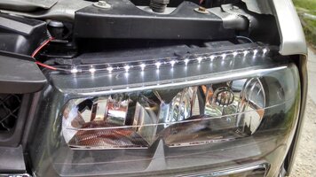

I would actually like to do something like that with the LED strips as my DRLs but I'm really not to knowledgeable when it comes to electricity so I don't even know where to start when it comes to wiring in those. I imagine it's just a matter of splicing some wires right? I also don't want to open up my headlights yet. Only have one pair and if screw it up I'm in trouble. My headlights are like $170 each (which is BS) so that will have to happen in the future. I have been researching the $hit outta this site over the last few months about headlights (so much so that my wife thinks I am part of a secret cult :yes: ) just to get a grasp on the cap mod and the quad beam mod.
Reactions: Midnyteryder196
Really the way I wired them in was super easy.. Just got an add a fuse, found a fuse that was powered with ignition on, and used that spot in the fuse block.
The strips use 3m tape and are mounted on the outside of the light.
Hmmmmmmm. That looks extremely simple and sweet. How do I figure out how to find a fuse that is powered with the ignition on?
Also, where did you get the led strips from? ebay or an led website?
I used spot 29 which is the 02 sensor I believe..
I bought mine on eBay from China, they was like $3.50.. I would look for a us seller maybe as I already have 1 smd out of my driver side and only have had em in for 3 months.
