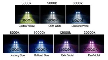

COLOR TEMP: Color temperature is the way HIDs are catogorized. they range from 3000k (k=kelvin) to 30000k. Its a common misunderstanding that the higher the kelvin rating the brighter the HIDs. Not true. The higher you go the bluer the lights will be eventually becoming pink at about 30000k. The most common kits are 5000k to 8000k. I personally recommend 5000k if your looking to improve visibility AND looks (5000k has a very slight blue tint). 4000k to 6000k will give you the most light output on the road.
(please be aware that ANY image of HIDs may not be 100% accurate of color due to the way cameras reflect light)

COLOR CHANGE If your not happy with the color temp you choose, all you have to replace are the bulbs NOT the ballast. Bulbs can be kind of pricey depending on where you shop so choose wisely.
