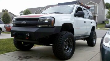

Lights all hooked up. Need to aim headlights, but got the marker lights working for first time in awhile. What to put the side LED strips on a switch or with the parking lights. The bumper lights do quite well for 27 watt Amazon units.
Yep. Got the book of faces. i run the one page for our platform on there.

What headlights are those?
