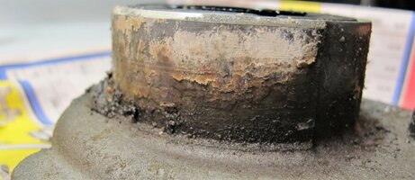

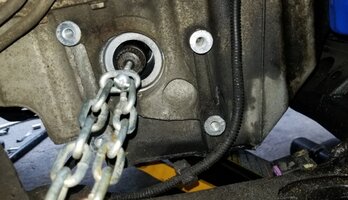

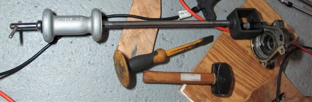

Had an idea. I attached the slide hammer to the top of the case and worked a chisel under the bottom. Little by little it worked free.
Can you get a picture of the back of that housing?
Reactions: coolride
This looks like the spot where it stuck. At the top where it's hard to access.
Stuck here too. this is the bottom where it was easier to work in and out with the chisel. So the oxidation is soaked with PB Blaster and WD40.

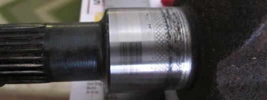

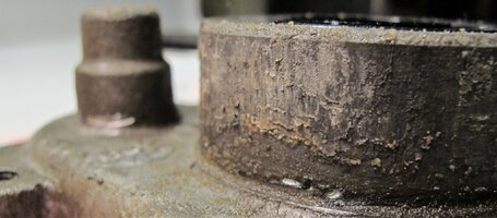

Just the surface that the seal rides on that seems to be chewed up or dirty. If you have the other one out, compare them. It it doesn't clean up with Scotchbrite and it's pitted/damaged, I'd replace it.
Reactions: coolride
That looks fine to me. It's pretty normal for that part to get shiny. No grooves or pitting, it's good.
Reactions: coolride

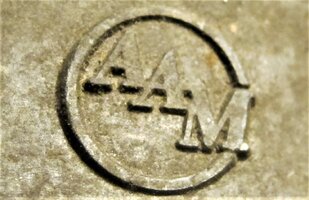

AAM customer service replied to my email.
"Hi
Sources for individual component parts have ceased to make the parts. You can get a complete assembled disconnect unit from any Dorman distributor or Dorman auto parts store."
Senior Manager - Aftermarket | AAM
Driveline | ATDC
1840 Holbrook Road
Detroit, MI 48212
O. 313-758-4176 | M. 313-701-1582
I looked at the Dorman castings (part# 600-115.) They appear to be original AAM disconnects. The inventory at AAM, must have been sold to Dorman. BUT, the Dorman product 600-115 listed on Amazon is a casting with the markings KAG (it's not an AAM disconnect.) If you search the same part number 600-115 at the Summit Racing website, they will offer an original AAM disconect.

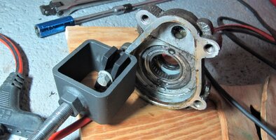

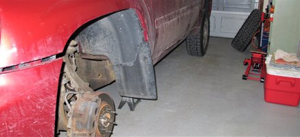

I installed the new disco today. And also the new wheel hub. I didn't install the CV shaft.
I went out for a test drive and something is still grinding (so I know it's not the disco, the hub or the CV shaft.)
My next plan is to remove the the CV shaft on the drivers side and disconnect the diff from the transfer case. I suspect the grinding is coming from the diff. If the grinding stops after the diff is disconnected, then I have my culprit.

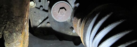

I used a slide hammer on the intermediate shaft and it didn't want to release (is there a circlip on the diff side?) My 4WD was working fine. The problem is I have a grinding noise in the front end. At first I thought it was the passenger side wheel bearing (bought a new one,) then I replaced the disco. And it's not the CV shaft because I didn't reinstall it, and it still grinds.
I'm thinking about moving this project over to the driver's side.
If you do move it over to the drivers side, do it in steps. First take out the CV axle. This isolates it to the Wheel area entirely, by completely removing the differential. If its still grinding, you know its in the wheel end. If its not grinding, then you know it COULD be in the differential. I say could, because you would have to determine if the transfer case is still turning the front diff of not. It shouldnt be, but it can be.

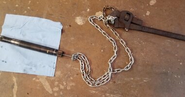

This is what I used to remove the intermediate shaft.
Reactions: coolride
Why did you remove the intermediate?
(I could use a few lengths of chain.) I suppose that my intermediate shaft could be damaged but the CV axle bearing on the diff side has a lot of free play. There's a real chance that it's the source of my grinding.
I moved to the other side of the garage (it's narrow.) Rolled the front wheel out of the way, and leaned it against the back left wheel... I heard a clunk...
The back wheel moves (push-pulling at 3 and 9 o'clock,) and something is clunking...
