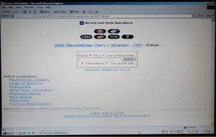

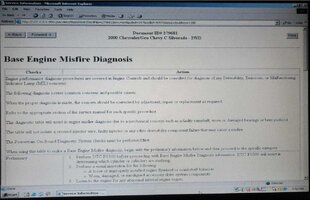

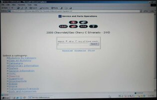

I just doped out how to do this ...but instead of using the RCA Cambio II Tablet with Windows 10... I went back to my Old School Installation of The Windows 2000 SP5 Setup on my Dell Precision M65 Work Station as the same Platform I used in the "Proof of Concept" TIS2000 Software installation some months back. THIS Time... I was able to Install the GM eSI Software OEM Dealership DVD ...and I just got it to Run PERFECTLY...
The TRICK was to RE-INSTALL THE APACHE SERVER APPLICATION using the TomCat Executable and BANG... the Offline IP properly Looped back to the Opening HTML Page for the GM eSI Application to correctly Launch in the MSIE Browser ... ONE Screen Refresh of the Browser Later... and it Hooked Up and I was Off To The Races!
MAN... I CANNOT Thank You ENOUGH for that Encouragement!

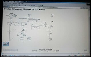

I just took some 'Quick &Dirty' Screen shots of the Dell Y2K OS Desktop Screen Prints to speed the results up and show some random "Proof Examples" for this Post:
GMESIDVD4INSTALL.jpgGMeSIEXAMPLE0.jpgGMeSIEXAMPLE1.jpgGMeSIEXAMPLE2.jpgGMeSIEXAMPLE3.jpgGMeSIEXAMPLE4.jpgGMeSIEXAMPLE5.jpg

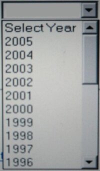

What year does yours go up to? Mine only goes up to 2009.
Edit: NVM, I just saw the DVD says up to 2005
This one covers 25 Years ...From 1980:
... to 2005:
But I noticed that the inception date for a lot of the main files on the DVD were Time Stamped in 2010... Not sure if that means anything or not... but I'll take this DVD for All that it is Worth since I have a 2000 Chevrolet Silverado and a 2002 Chevrolet Trailblazer. :>)

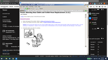

I have the VM Version that circulated via torrent for a while installed as a VM in my unraid server so I can access it from anywhere through my VPN. Not sure if yours has the service information from the older years, but mine only has bulletins for the older vehicles <1996. See attached pic for version information.Untitled.png

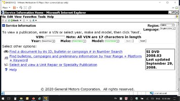

I just installed it on an external USB3 drive. The original VMWare Player wouldn't install at all on the host Win10 so I installed the latest version. Works great and super fast except that the screen on this laptop is so much smaller it makes the display so small I have to wear my reading glasses. Then I added a shared folder that shows up in the VM so I print to PDF directly to that folder. Works a treat.
I'm gonna try playing with the display properties or try to increase magnification in IE (the usual CTRL+ didn't work)

The PDF isn't the problem, it's the screen size on my laptop. Foxit PDF printer that came with the VM image is working fine. My old one was 17" while this one is a 14". I think I need another new laptop for these old eyes!
I think you need to change the screen resolution within the vm system, I have mine changed, and it looks fine on my end. (this is a screenshot from my 14" laptop with the vm in a windowed mode...
Edit: that or you could try setting text size to largest and going into internet explorers setting under accessibility and telling it to ignore font sizes...

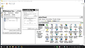

Yes, the ignore font sizes worked some. Just the main screen where it asks for year, make, model that the selection dropdowns are still tiny but the rest got bigger.
Tried changing the resolution in the VM and the player just resizes back to the same as before. Also used the biggest font size for windows and it did nothing. I'll try to get to the Windows accessibility settings but this bastardized version has no start menu and can't figure out how to get to the Control Panel.
Right click on the empty taskbar, and launch the Task Manager. Go to the Processes tab, find and terminate StartKiller. Less than a minute later, windows complained, throws an error, and wants to close Explore.exe, when it reopens Explore, the start button was back and you can get to the expected options from there. :thumbsup:

Success! Open task manager (right click in task bar>Task Manager), then File>New Task(run...), then type "control" and voilà!, control Panel opens. Then Accessibility Options>Display>select Use High Contrast, then click the Settings button>change the High Contrast Theme. I used High Contrast White (extra large) which was the best option for me. Odd thing though is that some windows don't resize, like in the pic.
After @Blckshdw posted the above info, I killed Startkiller and, in msconfig, I disabled it in Startup.
