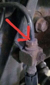

Are there any tips and tricks to breaking the brake line loose from the nut without twisting the line?
Been waiting to replace my front brake hoses but cannot get the line to keep from twisting at this point here
Tried soaking with penetrating oil, a little heat, repeat, soaked for a week, heat, just not breaking free.
I can turn the nut, just cannot keep the line from twisting.

@gmcman the way I did it and it worked on both the Envoy and tbss is crack it loose like you already have, disconnect the line from the caliper. Then remove the bolt holding the flex line to the frame and instead of trying get the fitting off turn the block off the fitting. Make sure to clean the fitting really well after and see if you can get it to turn freely if not then do those steps backwards. Get the block turned onto the fitting. Once it's close to it tightest position install it back to the frame with its bolt and then give the fitting its last torque down.
You know.....I can generally figure ways around things, and come up with a work around...but embarrassingly enough....I didn't think of this...thanks! I'll give it a try.

Lol.., hey man if it works for you like it did for me maybe the higher-ups can post it up as a FAQ and save ppl alot of time and money on replacing or repairing those hard lines.
You know what, thinking back on my youth (and that's a long time ago!), I used to do that too.
I'll be adding this to the FAQ :2thumbsup:
