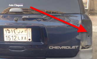

Thanks man those look nice! They're growing more on me by the minute. Saw them on eBay but seems the plug is different. Will post a pic of my plug later on today. Mine is a Japanese TB
Just remembered got spare tails at home. Here's my plug, is it the same? Thankssss

Looks good! I have to point out an area that not all the neat freaks are detailing properly, and they might be accumulating a butt-load of dust and dirt in this place:
:rotfl:
Lol thanks! You're right and I had just washed my truck this morning :s
