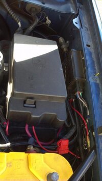

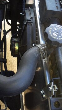

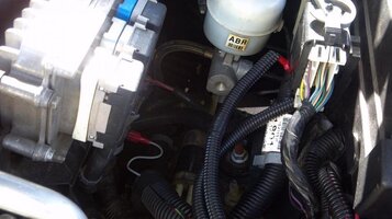

I decided to run an E-fan finally. The clutch on mine went bad so I had to do something. After looking around for the perfect controller I decided on the Spal pwm-v3 and a Spal 16" extreme performance straight blade fan. I had a aluminum shroud made that fit the entire radiator with the fan centered. If anyone wants pics I can get them. After the install I had to set the tempature on the controller, I used a Solus Snap-On scanner to set the tempature. I set it to come on at 205. When this controller commands the fan on, comes on at 60% and increase to 100% as the engine tempature continues to rise. The high side I set to 220 degrees. So far it has been a hot summer this year in Colorado and I have not had the fan come to 100% yet. The fan come on for about 15 to 20 seconds while I sit in traffice and then turn off for 5 - 10 minutes. I do believe that having the right combo of fan, controller and shroud you can E-Fan these motors and have them work just fine.

On the wiring that would be tough, I can tell you what I tapped into, but good luck finding the same controller. I had a hard time finding the one that I got. Spal has quit making that one due to new fan technology coming out. The did say they are making a new controller when I contacted them about the one that I got. I found it in a classifieds section on some random Ford Lighting forum. I tapped in for the sending unit signal at the PCM and the A/C power on at the power out side of the realy at the fuse box. Here are some pics. Forgot to mention fan was 170 and controller was 100. Shroud was made at a friends sheetmetal shop free of cost.

Very nice and clean looking setup. My only concern is the restricted airflow while cruising or at highway speed. There's nowhere for the air to go but through the fan. I saw this one at Summit Racing and though that it was smart to add openings with rubber flaps. The flaps would open while cruising but the suction from the fans would keep them closed.

I have thought about that, but at this time i have not had any problems. Like i said the only time that the fan comes on is sitting in traffic. I drive 40 miles one way on the highway and the fan does not come on. So i would say right now it stays cool enough.
How does the controller handle the A/C? Where did you hook it up? My problem is finding a way to have the fans stay on when the clutch cycles on/off.
I hooked up the the 12 supply to the clutch on the relay. The controller waits 15 seconds after the A/C is engaged and then 30 seconds after it disengages. So that way the fans stay on the entire time.
