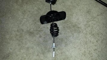

No unboxing video but these pics will have to do as a review. So far, looks good. They did do away with the secondary latch that is so problematic on the OEM part. Only grease I saw was on the winch mechanism. I'm not sure what the cable is made of because it was painted. Not too sure what to make of that. If it was stainless, why would they paint it? It is magnetic but then not all stainless steel is non-magnetic.
I'll have to get in touch with my contact at Dorman to find out about the cable. This was a major safety issue when car makers started putting spares under cars and trucks and they were falling off when regular steel cables were rusting out, which is why they went to stainless steel and added these damned secondary latches.

Bad news. Here's the answer I got:
The cable is made of steel with a black corrosion resistant coating.
Looking at this coating closely, it looks like paint and peeling off. I had flecks of it on my hands. Given that there is no secondary latch and the cable is made of steel and will rust anywhere salt is used, I will not be installing it. I'll just keep my old one made with stainless steel cable and keep putting the spare upside down to prevent the secondary latch from jamming. I cannot, in good conscience, recommend this product :no:
Sparky
12,927
I'd be sure to tell them that.
Mooseman
26,026
Ottawa, ON
Yep. Sent him an email with a link to the post.
