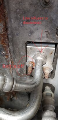

- Lastly, anyone got any bright ideas how to disconnect the rear AC line?!?! I have the bolt for it off, but the old line is still stuck on there good, and won't come off! I've attached a pic. 20200719_145710.jpg
Why do you need the stud off the compressor? Didn't the new one come with a stud?
I remember having that same issue, which was when I gave up and blocked it off. You could try PB Blaster. Maybe some heat from a propane torch but there is foam insulation there.

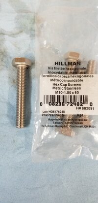

Nope, most compressors I saw online didn't come with the bolt, which is downright stupid IMO, but,
PROBLEM SOLVED!!
I was able to figure out the bolt size for the stud, and bought a hex bolt at Lowe's, took a grinding wheel to the bold head, de-burred it, and bam! She fits! $10 fix that saved me hours of headache trying to get the old one out. For the record, the bolt I used was M10-1.50 x 6020200719_164420.jpg
It's a little late, but Dorman 675577 Double ended stud 10-1.5 x 65mm (aka exhaust manifold stud) will also work. My new Four Season AC compressor from Rock Auto came with seals and stud even thou the description did not say so.
