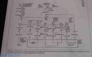

I'll see if I can pull it up in the wiring diagrams but from memory I would say the orange wire brings fused power to the transfer case shift encoder motor lock and also the TCCM.
The tan wire should run from the transfer case shift encoder motor to the TCCM.
Here is a similar Wiring Diagram to compare against your Wiring Color Scheme:
EDIT: OOooooops...!!! Wrong Diagram... The CORRECT One is Further Down Below...

Thanks for the Correction @TJBaker57 ... Tom... I Copped a "CORRECT Screen Print" of the proper TCCM Encoder Circuit being shown and used by Eric "O" for Diagnostics via his Tech 2 from his On Topic Video and dropped it just above this YouTube Video in my last Post... :>)

You have to check for proper continuity on all the wires from the TCCM to the encoder motor. Since you said you already replaced part of the power wire, it's quite possible the rest is at fault.
I re-replaced the power wire a shop only did from the fuse block to right under drivers door i then replaced from fuse block clear to the encoder plug also got in the truck this morning have full power lights are on .. on the switch I just can’t switch between functions
There is more than one wire. Follow the wiring diagrams. They are available from the manuals (link in my signature)
Reactions: gmcman
Thank you all you guys are awesome I wound up unplugging the whole harness pulling it down and out clear to where it went through my body mount is apparently these wire looms rub the body mount pretty bad the tan signal wire was rubbed raw and had blue corrosion all over cut the nasty part out found good wire connected it taped the looms secured everything threw some extra tape around looms to give some extra protection and put it all back together and bam life’s good works like a dream needless to say it has a new encoder switch and front actuator all for two corroded wires that the body mount rubbed through thanks for everything again I woulda never found it if it wasn’t for the help and schematics
