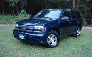

Figure it is time for my to start a build thread for this site.
Current Pic.
This is the oldest picture I can find, no tint, stock radio etc.
Truck purchased Oct 29, 2007 from a dealer in White Plains, MD. Had about 42k miles on the ODO.
It was taken to the shop to fix a few problems, new tires, lift gate 3rd brake light cover was flapping at highway speed, dings, and something else I cannot remember now lol.

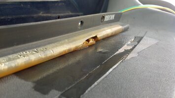

Some of my first mods
Deezee dash kit
Old wire mesh "noob" grill
Fresh window tint (4 years ago)
and removed roof rack
I will post some more later but this was basically my first initial mods.

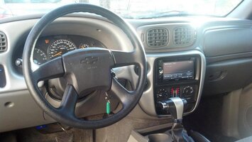

I hit a deer around the end of December and was waiting till after winter (it never came) to get it fixed, but this what threw me into my current Mod bug phase.
This happened Jan. 3rd, came out to leave for work and realized real quick my day went from being sweet to real f-ing bad real fast.
I figured hell the shop is going to have the truck, they can fix the deer strike while its in. $3100 total for vandalism, deer strike was $3500.

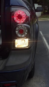

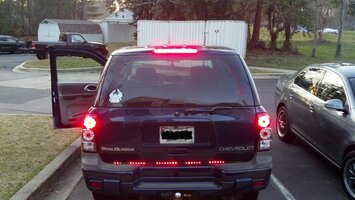

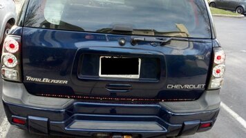

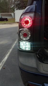

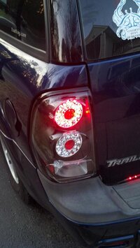

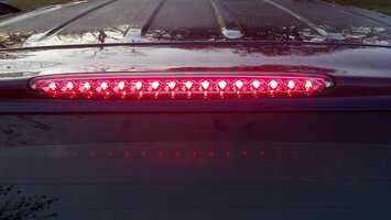

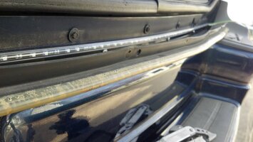

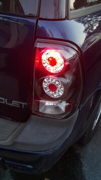

New LED tail lights, old ones had some cracks and bad scuff marks and scratches so they got replaced.

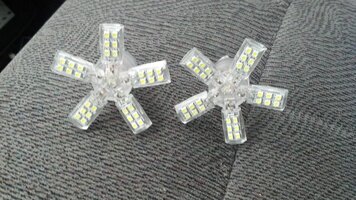

Also picked up an Avalanche LED 3rd brake light, a set of spider LED reverse bulbs
Yes my old light bar was really screwed up. The water on the bumper is what drained out of the old bar after I removed it. I love the new bar just need to fix my remote start issue.

TexazReece said:
for your taillights the resistor is kind of just hanging did u tape it to the light housing, because I just got mine in and the resistor just hangs and seems like after installing and driving the weight from it will loosen then wiring for the led taillights?
My taillights have resistors built in, that is the wire for the LED bar. The white one was for the reverse. Now it sends activation signal to my reverse camera. I still have a few things to clean up.

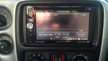

The truck is looking good I like it!! That HU is looking clean and doesn't stick out! What was the model number for that sony and how well is it working?
You plan to get ss rims or drop the ride?
blazinlow89
Jan 25, 2012
2,088
Sony XAV-62BT. The new model is the 64BT IIRC.

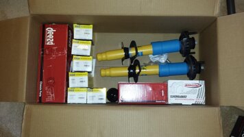

Im at it again, i have another thread going about parts brands and figured since it is turning into reality now I will add some stuff to my build thread.
Currently I am doing a front end suspension overhaul to help with some vehicles sway and some clunking (sway bar end links shot). Since I will be pulling it all apart I figured I would go ahead and throw in the lift kit (MarkMC 2.5") I bought off Janesy last year.
SO far on my list of crap ordered
Deeza tie rod ends- rockauto
Deeza Sway bar endlinks front and rear- rockauto
MOOG upper and lower ball joints- rockauto
MOOG strut mount bushings- rockauto
MOOG wheel Hubs- advanced auto parts (fiance bought one)
Bilstein HD struts- shock warehouse
KYB strut mounts- shock warehouse
Prothane Control arm bushings- prothane suspension parts
Marks 1.5" wheel spacers- LIFTmeister (fiance bought these too)
BDS 5500 rear shocks- BDS
Prothane sway bar bushings front and rear- autozone or advanced cant remember
I also ordered some new front speakers, going to move the POLK 2 ways to the rear and I have a set of PPI 6.5" components for the front (under $50)
Now I am waiting for the parts to arrive and hope to be a busy boy next weekend. I will post pics as stuff arrives and work begins.

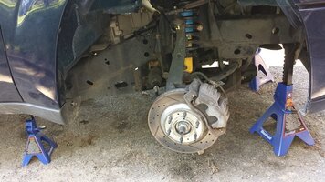

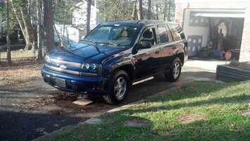

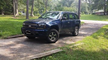

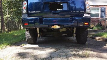

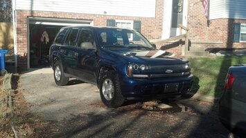

Well the lift is installed, as well as most of the stuff I ordered (prothane bushings). I love the way it drives, it feels like a truck now :biggrin:, getting used to having steering that does not float now.
As for the job itself, none of it I would say is hard. It was a bit difficult not having an extra hand with any of it, not to mention fighting certain components along the way. The rear went pretty easy, my only complaint with that was fighting the sway bar end links. Passenger side required some sawzall action, driver side sawzall and die grinder (cut the shank for the ball rather than the bolt). Putting the springs and spacers in was easy as well as the new shocks. Only compressed the springs about an inch or so to get them to slide in. Took my 4 hours total with an hour of grinding.
The front was how do you say time consuming. The lower ball joint on the passenger side literally kicked my ass around and me wreak of failure. Spent 4 hours off an on trying to get it to go with no luck. Put heat to it, beat it everything I could think of. I went and did other things like the upper ball joint, strut etc then would come back. After failing to get it to budge I sprayed everything with some more PB blaster before putting my tools away. Being exhausted after 10 hours of work on Sunday, I cleaned up and went to eat and go to bed. The next morning I came out and decided to give another try, first attempt nothing. After some frustration I cam back with the 4 lbs sledge and hit the top of the BJ press. The damn LBJ popped right out. Feeling excited I was able to put the passenger side back together fairly quick, had the strut back in place, lower strut mount, new tie rod end, UBJ, LBJ, wheel hub and the new sway bar endlink (everything but the UCA). I had about an hour to finish tearing the driver side apart before having to get ready for work (needed a ride as the truck was on jack stands). Total time on Monday 5 hours.
Now comes Tuesday, I wake up at 6:30, being difficult as I get off at midnight and am usually up until 2 am. I walk the dog and get ready to go tear back into the project. By 8 I had the UBJ, and LBJ pressed out and the new ones in. Pulled the strut to swap out with the Bilstein HD and the lift spacer, now comes the F-you moment of the day. The top mounting bolt for the strut was so corroded that the allen wrench instantly rounded out the hole in the top of the OEM strut, figured ok lets go with the vice grips. Now the metal threads for the mount are starting to just fall off they were corroded so bad. Try for the metal piston, just spins. At this point I am at a cross roads, do I cut the nut, the piston, try and take it to a shop. After some debate and finishing up swapping the UCA's I come up with a plan. I put some more tension on the spring compressors to get the spring away from the top mount so it has no pressure behind it. I begin cutting straight down the strut rod with a sawzall, while the spring is compressed (This is a do not try this at home kids warning[/B). This is the most terrifying and dangerous backyard mechanic work I have ever had to do. I get the cut fairly straight and get to the nut, get about half way through the nut and then the top mount washer is next. I cut all the way down to the center nut washer and through, 4 dewalt blades later and 35 minutes the nut just falls off. I get the strut back together and installed as well as the new tie rod end, and go in to get a wrench and see the 1/2 upper spacer sitting on the tool box :hissyfit:. Get that put in and everything back together.
So I start doing final torque checks on the driver side around 10:30, wheel and spacer installed around 11:15. Go to passenger side and forget to set the torque wrench back to 35 ft/lbs for the pinch bolt, about 3 turns in POW. The bolt shears and I can only think WTF then realize my mistake. Find the old bolt and nut in my scrap pile and get that back in. I finish at about 12:15, clean up and call Mr. Tire to let them know Im bringing it in for an alignment. On my way pver I keep hearing a crunching sound, turns out the inner fender sheet metal is rubbing against the UCA :hissyfit:. So I drop it off and go to lunch with my Fiancee. Guy calls me and explains the camber/toe issue with the lift I tell him to get the toe straight and the camber should be ok as I can rotate the tires more frequently. He calls me back an hour later ( we were on our way back) and explains that they got it to well within specs and still had about 3/4" of threads in the inner tie rod. I had just enough time after heading back home and changing to cut some of the sheet metal out with the sawzall.
SO far I'm happy with it.
I also hacked off the hemorrhoid after all these years. Still need to weld a tip on.

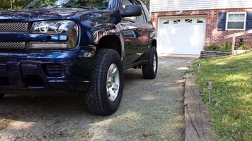

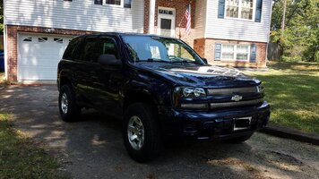

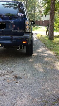

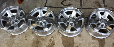

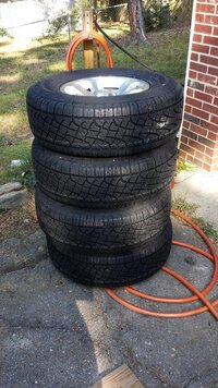

I picked up a set of wheel adapters from Kyle (HARDTRAILZ) and since then I have been on the hunt for new wheels. I picked up a set of Enkei OEM Toyota wheels for $50, just had a set of Pirelli Scorpion ATR's mounted to them. They do stick out a bit tread about 1/2" side wall about 1", might look into doing some kind of flare to cover them a bit. I also picked up a set of Silverado wheels with a set of cheap tires for $20, still debating what I want to do with them. As for now I love the way it rides with the Pirellis, wheels look sharp on the truck.
I have also removed the rear tire winch and am looking into making my own rear tire carrier. I also need to get these bushing replaced in my upper control arms, they squeak terribly.

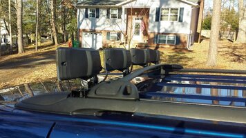

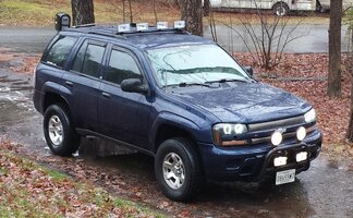

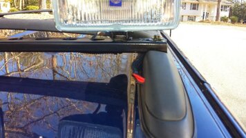

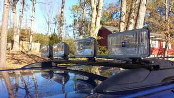

First I installed some Hella 550 fogs, however I did not take photos of them installed. Just Imagine the smaller 450's only bigger.
I also installed a set of Hella 500 FF driving lights, while I will agree with James that the cornering lights provide more usable light, between my headlights, the 500's and the 550's I can light up a lot of area. Also had to install the MD plate to comply with outdated laws.
I have the fogs wired up to come on with the running lights, so my new DRL's if you will. Works for me as I drive 5 miles to and from work everyday, and only use the truck for long drives. Also some ice from todays travels.
The bull bar works very well for giving me a stable area to mount lights, while I do know the mixed feelings on them I can say it works for me.
Now for some light spreads
Hella 550 fogs only
Fogs and Low beams (4300K 35w HID in the projector housing)
Fogs, Lows and Hella 500's
Of course Fogs, lows, 500's and the high beams (cheap H1 bulb)
Just the fogs and 500's
The Hella 550's will find new life atop my roof.

IllogicTC
Dec 30, 2013
3,452
Did you run the roof lighting wires through the spot where the wires would have run for those goofy Northface Edition lights or something? I like how it turned out, you see the mod but don't see any of the ugly unless you know where to look.
blazinlow89
Jan 25, 2012
2,088
I drilled a 1/2 hole and put a rubber grommet in to protect the wires, ran down the b column to relays under the seat. I need to get pics of the wires redone and the connections under the cap, I switched from the mesh loom to large heat shrink so all you see now is a 3/8" black cover. I just notched it so the wires would go in without obstruction. I also removed the loom from the bars wiring as went with single strands of 14gauge so no splicing was involved within the bar.
Thanks, there are a few things I am unhappy with that I will fix later.
