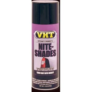

I want to keep it red but led style to match the led taillights which paint did you all use or which is best to use??
VHT Niteshades is the most common. Rustoleum has come out with a similar product, that's pretty new to the market. If none of your local stores carry either of them, or are out of stock, plenty of places online sell them. :twocents:
Edit: VHT does make a red tint, some members have used it on their Voy's tails for the amber turn signals, don't know if Rustoleum has a red tint spray yet.
That's what I used on the 3rd brake light and tails on the 'Hoe. It worked just as well as VHT. :twocents:
