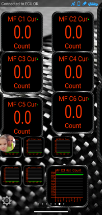

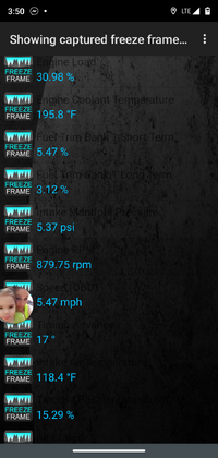

Newest pisc hopefully these help. Ton as of misses on 3

I would pull the #3 plug and inspect. If it's extremely fuel fouled it may need to be replaced. Not as much of an issue with iridium plugs but they are still susceptible. Does the #3 coil have the spring inside the boot?
trims seemed to have improved since the original posted data. These posted data show an rpm that is not idle... I am assuming it is a freeze frame capture associated with the coding of the misfire.
Something "interesting" maybe is that the "current count" has no registered counts for the "troubled" cylinder... what's with that... ie what is the attachment about?
If I have a misfire, I generally don't see a previous history using my OBD adapter through the Torque app from subsequent drive cycles, only current.
