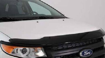

after close observation the envoy/TB are completely different.
this fords shape is kindof saabish.
HARDTRAILZ
49,665
Kinda like this ford?
Reactions: I_Shoot_Back
