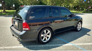

I'm at 31.5 all the way around in the Envoy and its super level. The trailblazer SS in the shot is stock height. Both have the beltech shocks and springs but 2 different kits I have the lowering kit on the Envoy while the Trailblazer got the stock height beltech kit.
The beltech kits sold over at tbssowners.com from NorcalSS are a solid choice to get that rear down.
