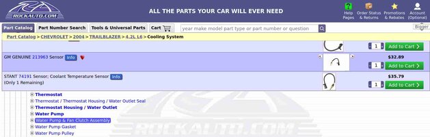

The Last Device in the "Loop" for Thermal Sensing would be a possible errant Thermister Temp Sensor Pick-Up point for sending Temperature Data to the PCM... Located in the Engine Head-Block (Driver's Side, Front, Lower Area). All Thermostats respond to the Physical "HOT or COLD "Changes inside the moving 50/50 Mixed Water & Coolant Column...BUT... it is the Thermister that alerts the PCM to the conditions necessary to Turn On the Electro-Viscous Fan.
Available at RockAuto HERE:
The other issue is that there are TWO Choices for OEM Thermostats for the GM 4.2L LL8 Atlas Vortec 4200 Engines: ACDelco (GM) or STANT. These Images show all of the OEM Components when Brand New for your visual comparison and Part Number Cross Checking:
42681914344_8e73717894_c.jpg43350753812_8e38c6ea6b_c.jpg42681914884_370404812d_c.jpg42681914694_e8da33b63e_c.jpg43350753422_8664ea0016_c.jpg42681914644_04f171ce67_c.jpg43350752972_0d703db505_c.jpg43350752792_bdfbe31b35_c.jpg42494510135_0bc79faea8_c.jpg42494510095_be9991e57d_c.jpg42494509935_16f89d1063_c.jpg29528236068_c83fb06e3a_c.jpg29528230828_646a8b7b25_c.jpg43350773022_f4e28013ff_c.jpg43350772942_0ac0ef4ecd_c.jpg29528230478_13b296c193_c.jpg42494505325_60aee32f3a_c.jpg
Since the Serpentine Belt drives the Water Pump... having one of the Correct LENGTH may also factor in How FAST the WP Impeller Blades can push against the Coolant Water Column... First up THROUGH The Engine Head...and then down through the Water Jackets inside the "Lost Foam" Block casting.

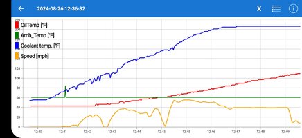

The EV fan clutch does start to engage at 211f however really cranks up at 228-232. This chart shows the engagement temps and %.
noname-jpg.56927
225f is not super hot but the fan would start pulling quite a bit. If you don't have a bi-directional scan tool to perform functional tests, you could use this method to make sure it does work:
How to test the electro-viscous fan clutch
If it doesn't work, it would be especially evident with the A/C on high, just idling, it would not be very cold or even warm but would cool down while moving.

Thank you for the time you spent with the pics!!!! Well I definitely pulled the OEM thermostat out. The Stant is the one that has the rubber around the plunger and looks very different then the OEM one I pulled out. One less thing it can be. I did have all the hoses off when I did all the work I mentioned and did not see any obstructions unless they moved to the head?
