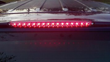

IT fits, just did the mod about 3 hours ago. It is pretty crazy that the lights are exactly the same, but I guess the Avalanche has a larger market than the TB. I mean seriously even the little center mounting tab is in the same location. Be nice if it could act as a parking light and a break light.

I have modified my 3rd Brake light with led
