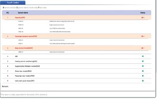

Hey everyone, hoping I can get some answers here. I've been chasing some persistent issues since January.
Attached below is a screenshot of a relevant report (recent)
Here's a recap of everything I've figured out so far. If any clarification is wanted for anything please ask, I'm sure I'm missing something.

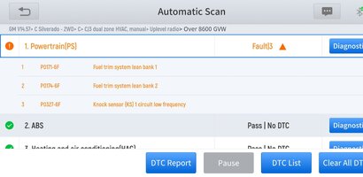

I got CEL to come on when turning the key forward, went on a test drive and got speedo + odo counting again. First time I've ever seen the CEL or the Speedo/Odo work on this truck.
Scanned the truck and have 3 CELs, 2 for running lean and 1 for knock sensors I already knew about.
Still too early to tell if it long term fixed the solution, I want to give it a week or two of consistent driving before calling that done.
However, when I turned the truck off and turned the key to the on position again, I have no CEL lighting up. Everything else is still working though.
