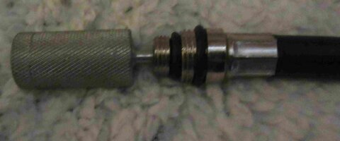

It just might... but for the minimal amount time the ACDelco TEC would be getting sprayed down through the Neck of the Air-Fitting Side of the Compression Hose and past the Spark Plug Holes... it probably will not have that much of an effect on the Rubber Lining ... especially as suggested earlier that the Compression Hose should get purged with Brake Cleaner immediately after topping off all (8) Cylinders.
But ... What The Hell... Let's Give it 'Real Test Try Out' to find out for sure... Yes?

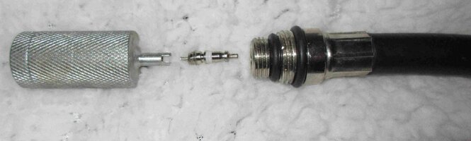

I have assembled everything needed to do this scientifically as shown in the attached Images. As you can observe... it does become necessary to remove the OEM installed Schrader Valve... so the Tool shown ...or something like it ...will be needed open up the pathway for the TEC Spray.
I'll be using use the ACDelco TEC Foaming Spray as displayed and completely spray down and submerge the entire Hose inside of a Plastic Zip-Lok Baggie and leave it in there for 24 Hours. Of course, ordinarily... This is something I would NEVER do on purpose. But the Question you raise here is a valid one... and it does deserve a definitive Answer. I'll follow up on this within a Day or so and post up the Results with Images:
Uhhh.... The 'CAN ' of TEC will NOT be inside of the Baggie during the Test... Just the Foaming TEC of course... I just wanted to show it in there now... to convey the idea of what is about to happen... :>)

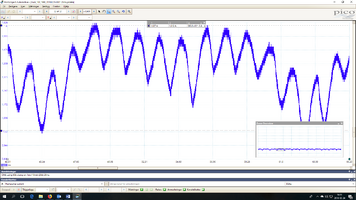

But... before condemning the EFIs, I'd also want to put a 'Scope with a Low Amp Clamp & Loop into the Fuel Pump Fuse Location and observe the Dynamic Electrical Behavior of the Fuel Pump for indications of either Lost Commutators or Low RPM vs. Poor Fuel Volume Delivery as well... just to be sure that the Fuel Pump wasn't Misbehaving.
A properly functioning Fuel Pump should produce a Wave Form that looks essentially Flat and Even along the Oscillating Horizon with roughly an even appearance of its Peaks and Valleys in the Scoped Electrical Signature. THIS is what a "Known GOOD Fuel Pump Wave Form" should look like:
THIS is what a BAD Fuel Pump Wave Form that is on its 'Last Legs' looks like:
Eric "O" From SMA (South Main Auto) Has this *SWEET* PICO-Scope Fuel Pump Diagnostic Demo of exactly what I've mentioned above. Using THIS Diagnostic Method achieves a Rapid, Non-Invasive and DEFINITIVE Diagnosis.
Remember that Poor Fuel Delivery can produce Random Lean Conditions based upon Poorly Atomized Spray patterns coming out of the 'starved' EFI Pintles... and you won't be able to SEE these events in action like these by merely "Checking Fuel Pressure on a Running Motor".

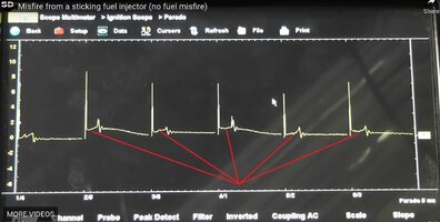

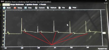

Just to "Drill Down" closer to what a "Stuck Fuel Injector" might look like if your Motor is experiencing this problem with a Consistent High Misfire Count on One Particular Cylinder.
Observe**** how easy it becomes for this problem to be MISSED if the Ignition Parade is observed on the Oscilloscope while the Engine is strictly "At Idle".
Have a Look at the Sequence of Three of these Four Recorded Secondary Ignition Firing Events.The Red Lines point out How Similar the Secondary Spark Firing Lines are for ALL Five Cylinders shown in this Ignition Parade... At Idle:
But... Observe what happens to the Spark Line during a sudden "Snap Throttle Event"... Notice that IT Climbs even Taller than the Primary Discharge Line. It is THIS Known BAD Wave Form Image that demonstrates that Cylinder #5 in this 5 Ms Time Division Parade is going EXTREMELY LEAN ... and the EFI has either become Stuck Closed or has Failed:
**** Credit... All Screen Prints are from Paul "Scanner" Danner Youtube Videos
