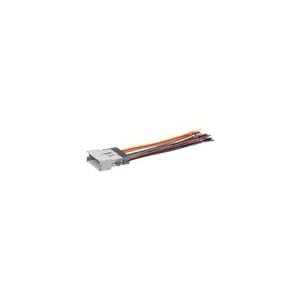

Hello, I will be installing a Clarion VX-401 head unit soon. I don't care if my Chimes or On* work anymore. Will this wiring harness work for what I want to do?

Just wanted to double check before I bought it. It would be nice to hear from someone that has actual experience.

Sure will, but it won't be 100% plug and play. You will have to wire in a switched 12v lead to the red (switched) wire of the Clarion. If you need help on this, don't hesitate to ask.

Awesome, thanks. I should be able to just take 12v's from the cigarette lighter?

You could, as other TB/EV owners have had no problems doing it that way.
Personally I don't, I get switched power at the steering column harness. The reason is, modern head units with decent sized internal amplifiers can draw enough current at higher volumes to pop the cig fuse.

I don't know what I was thinking, but the cig lighters are not a switched 12v on the trailblazer. :crazy:

Based on your reply I assumed you didn't want switched. Some folks have requested a constant 12v source to have a key off/radio on feature. I used to call it ghetto-RAP but some people thought it was too harsh.

No, you need to tap into a switched + and you'll lose RAP
