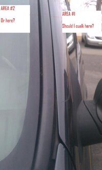

Sorry for the delay . Yes the pictures do help. I also went out and looked at my truck so I could explain better. What you want to do first is to find the leak. In area #1 the rubber is covering screws so that you can remove that molding. You can just peel the rubber to expose the screws or pull it out so you can get at them. You should be able to just exposes the screws so that you do not have to take it all out. Can not remember which is easier but the rubber will push back in just do not ripe it taking it out., Remove gently you will see how to as you do it. The molding once the screws are all out will come off it might have some two sided tap on it but it will come off , just work it and be careful. Now blow the air from the inside or out feeling for the leak. On the roof it would be easier to blow from the inside and then feel on the outside. When you removed the molding is it full of rust at all. We will say you found the leak now. On the side 1st . Just run a bead up the side smooth it with your finger then clean the edge of the glass leaving it on the edge put the molding on clean it better all is good. If it is on the roof it will be harder. If we take your picture and put it on the roof that will give us the orientation to do this. The rubber molding will have to be warm so we can get at it from position #1. We used a nylon type tool that we could push in to open it so we could get the nozzle pushed in to fill it across the top, do not pry to hard or you could possibly crack the glass, just be careful and you will have no problems and do not rip it. Then take the nylon tool and work the molding back down, clean up use a solvent that won't hurt the paint. Hopefully I have explained it better thanks for the picture. The nylon tool could be something that is not to flexible but won't scratch the paint. The caulking should be the stuff that does not harden.

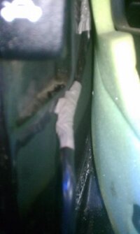

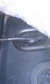

I took my trailblazer over to safelite auto. They checked for leaks around the windshield and couldnt find any leaks and said the seal looks fine around the windshield. I lifted up my carpet and saw a little water around the 4x4 cable where it runs up through the floor board, the carpet was damp around it too. I noticed a little leak coming from a hole where a cable mounts at on the wall near the hood release leaver.
I sealed both of em, so I hope this is it. Well see what happens. Ill keep you guys posted.

Thanks, but I looked at your pictures and what you wrote and it wasnt the same problems as mine minus the leak on the top corner of the A frame. both of my leaks that i seemed to have found came from the floor. One was at my the cable coming up though the floor board and another was right under the hoodlease lever near the floor, both on the driver side.
Me too. I thought it was coming from that cable also because that's where it collects and seamed the wettest. But it wasn't. It comes down the a frame and drips down right next to the hood release. Mine was only on the drivers side too. Try those four screws that hold that piece of molding on, on the side of the windshield.

Sorry for being so late to respond. If I remember correctly the molding was covering those 4 screws on the driver side A-pillar on the outside. After I removed that I saw 4 screws and i caulked them all very good. After that I have not had any problems with my carpet getting wet. If anyone reading this was experiancing the same problem The first I would do is seal the 4 screws on the A-pillar, The screws are on the outside, not inside, and are covered by the molding that cuases a seal around your car door so no water gets in. All you have to do is peel it off and youll have access to the screws and than caulk em up. Hopefully that will fix your problems as it did mine. Thanks everyone for all you help :thumbsup:
