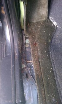

*UPDATE*
Ok, I took off the A-frame cover and didnt see any signs of leaking from there. I removed the bottom plastic trim on the floor where the carpet ends at the door. It looks like it might be coming from some where in there. Im gonna dry the area and take it to a car wash to see if i can see where it leaks. Here a pictures of the A-frame removed and the floor trim. I live in the chicago area so i do get alot of snow, but its not from snow simply being tracked in my car and melting because its been like this since i bought in August and it would get wet after it rained. This might also be the cuase of another problem im having which ill post about it in my other thread. (See p1271 and unknown driver in DIC, dont want to get off topic here)

Ok, I check the AC drain to see if it was clogged but it was completely clear. I went through the car wash and noticed I was getting a little water coming in through the top corner of the windshield on the driver side, id image alot more water during alot of rain. So i got some clear indoor/outdoor water proof sealant and sealed the corner. Ill leave the A-frame cover off to keep an eye on it. So I hope thats my only problem. I Checked the door seal and it seemed ok, but i noticed I can pull it away from the frame a little bit in one section so i might seal that as well if guys think thats a good idea:undecided: Ill check the rubber gromits as well. Next step is I gotta pull my carpet back and dry it and the padding underneath. Im assumming i have to remove my seat in order to do that unless you dont nessesarly have. So far so good, il keep you guys posted.:thumbsup:
You may have found your poblem. A good idea to check everything, and I would reseal that weather stripping. I don't think you want another water probelm.
Also, I would get rid of as much if not all that water. I made the mistake and fried my 4wd control module.
Do not use silicon to fix the leak in the corner of the windshield. Use proper windshield sealer because if you ever have to replace the windshield the proper sealer does not stick to silicon.:no::no:

Thanks for the info, but its to late now. But if I have to replace the windshield ill just remove it all, i didnt put much on. Ill reseal that weather stripping on the door too.

Its been i week since i sealed it and no water or rain has got it. However i went through a car wash and noticed water started coming in through the back. I checked it out and saw the door seal sagging down so i resealed it and put it back in place. I must of knocked it down while moving stuff in and out of it becuase iv never had a problem before. So far so good. I havent got around to unsoaking my rug and and cleaning due to beening busy moving and im going to be busy all this week and weekend. Im hoping to get to that next weekend. Ill keep you guys posted.

I found it on the drivers side, top corner of the windshield. I have pictures on it in my prevoius post. I used silicone adhesive to seal it but I did that before you gave me no no for it lol.
