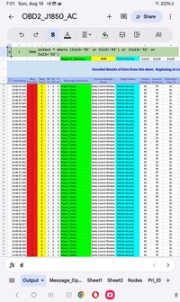

Here is a long shot question that I surmised would be best put here.
Having VATS tuned out of your PCM... Is there anything left there to reply to the deluge of BCM serial data traffic that otherwise goes unacknowledged??
I never thought about it until just today when tinkering and recorded serial data traffic with a BCM, DDM, CJ3 HVAC, LGM but no PCM on the imformation bus.
BCM spat out like 20 vehicle security messages per second for nearly a minute before giving up.

Well, it is called a "handshake"
Yes, Normally looks like this....
But without the PCM participating I see this on a benchtop.... Looks pretty one sided! But what I wonder is if some level of participation from the PCM is retained after the tune.
Is there anything bad that could happen with ignored messages?
I am thinking no. When I have seen messages go unacknowledged the sending module eventually stops sending or asking for such messages. Perhaps in some cases the sending module reverts to using some default data?
