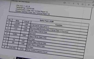

Please Review the Classic Video linked below produced by Will Robinson on "How To Diagnose Class 2 Network UXXXX Codes" and follow his Step By Steps for Isolating BOTH Splice Packs:
(1) Located under the Driver's Side Knee Bolster on the Left Side:
(2) Located under the Passenger Right Rear Seat ...under the Carpet Flap:
These instructions will help to isolate ALL of the Modules in the Vehicle in both the Front & Rear sections of the SUV and help to run down the Errant Module. Please do not start by changing or disassembling any Vehicle Components until you have a more precise direction in which to go...including any Suspect PCM without first examining the Wire Bundles and Three Connectors for Damage or Wire Breaks:
