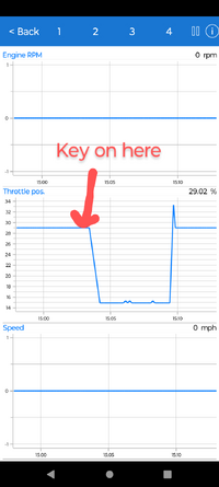

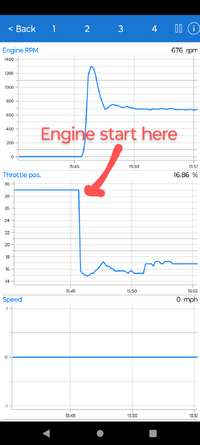

Does anyone know the normal TPS percentage at key on engine off and at engine idle?
I'm seeing 23.1% key on engine off, jumping to 29.2% after about 3 seconds. WOT is 87.9%
Engine idling it varies from 16.3% to 19.6%.

Taken from this, it appears that your TP is "rock solid" at engine off (first three charts). Then the OP appears to have some electrical (poor connect?) / mechanical problem (looseness).... maybe
I will try to get a read today at engine cold, key on, engine off for an ample duration.
I might not be able to get Car Scanner to graph right from the key on as the app requires a reply from the PCM before it initializes. But there is a chance I can work around that.

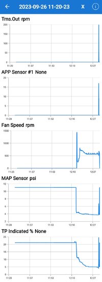

Key on, engine off

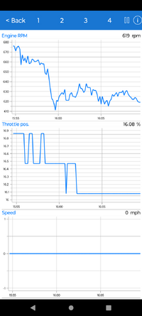

So it looks like your throttle is consistantly a tad high. Is your throttle body filthy? What are the MAP readings like at idle? I don't know if that would make a difference, just reaching here for a reason for the throttles to be elevated.
Here are some of mine from yesterday....
Here the truck sat at key on engine off for like 40 minutes before starting. Throttle position was stable for that duration before starting. Vehicle was allowed to warm up at idle for near 20 minutes. No accelerator pedal action for the startup/warmup. The throttle got as low as 4.65% when the warmup was complete.
Unrelated but I caught one of those instances when my EV Fan clutch apparently had no fluid in the working chamber and as such was very slow for a minute or so.

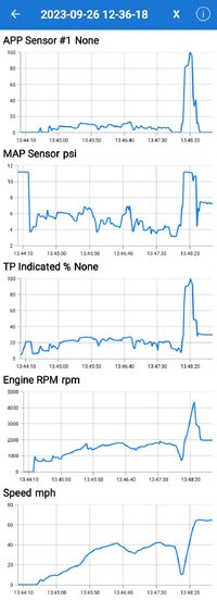

This one shows a range of operation including a pretty strong pull which I practically never do.

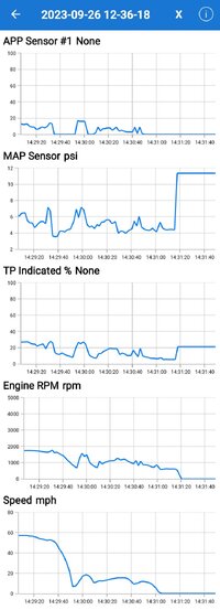

And lastly the end of a drive where it is seen the throttle is about 5% at idle.
What does this all mean? I have no idea other than your throttle seems to be higher than mine.

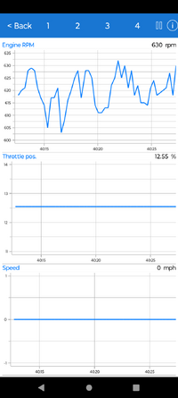

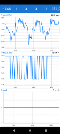

...in a related Thread... Consider this a "Fish-Bite" Throttle at Idle issue... as demonstrated by your RPM Graph in Post #7:

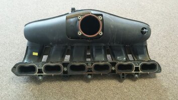

On the outside chance that you are getting transient vacuum issues around the perimeter of the Intake Manifold allowing un-metered (unmeasured) air to get ingested... try CAREFULLY re-tightening the 10 Perimeter IM Flange bolts back down to a mere 89 Inch Pounds ...and NO MORE. ...and then run the same test of the Throttle Body Position vs. Engine Idle RPM again to see if this action affects the Engine Idle in any way and alter the "Fish-Bite" Pattern at Idle.

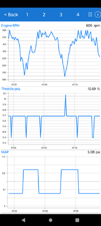

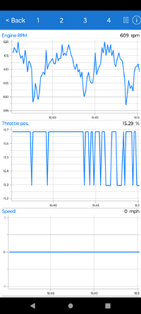

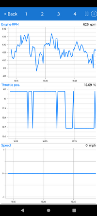

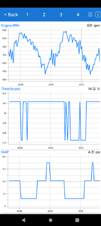

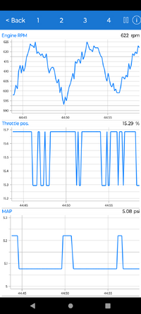

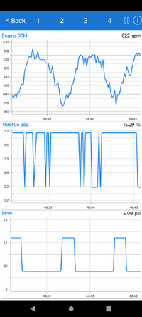

I caught this anomaly
I don't think I am seeing any anomoly here. What I am seeing are fluctuations caused by the conversion of analog voltages to digital values. Your graphs are simply zoomed in way too far.
Let's take the throttle position for example. It looks to be spiking up and down. However, on close inspection these spikes are roughly just 0.4%. Not enough variance to cause much of anything.
The throttle position has a range of 0% to 100%. A single byte has a range of 0 to 255. So to represent the throttle position with a single byte each bit is 100/255 = 0.392%.
So that "spike" in the throttle graph is the minimum value a change can be, one single bit.
Similar for the MAP sensor. The MAP sensor value is reported by the PCM in kPa. To convert to psi it is multiplied by 0.145038. So the minimum change in psi is 0.145.
The graphs will look like they are jumping about when zoomed in too far.
I think what I am seeing in the first set of graphs may be this...
The engine idle RPM drifts higher in response to something like an intake manifold leak. The PCM sees the idle speed going higher than the desired idle speed and tries closing the throttle a very small amount. This causes the throttle position displayed in the graph to fluctuate as the digitized value approaches a rounding point in the equations as the throttle position just barely reduces. The closing throttle lowers the MAP value and a similar artifact of the equation for the MAP sensor causes the drop seen in that graph.
I think I might look for a intake manifold leak or mybe a leaking EVAP purge valve or the like? Just a thought.

I checked the intake manifold bolts and they were slightly loose. I decided to take the manifold off and it was very apparent that the gaskets were bad. Replaced the gaskets, cleaned the manifold and re-cleaned the TB. Did the relearn again.Screenshot_20230930-125104.png
