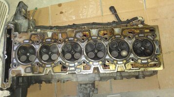

Long story short, over Labor day weekend I had to swap out my engine. I had lost all compression on one cylinder and when my uncle checked his GM book on procedures, R&R of the head was going to take longer than swapping the motor. It's a good thing we did so too: I broke two head bolts later in the block. We got them swapped no problem and my newer motor with 100k fewer miles is running great. But here's the problem: the salvage yard didn't charge us for a core. So I have the motor in the basement to play with. My dad and I pulled the head and found this on the no-compression cylinder:
Yep, that's a gaping hole in one of the exhaust valves. All the other valves are immaculate as seen here:
And the pistons are in great shape except one that is a little looser than the others (same cylinder as the burnt valve). The cylinder bores are in great shape too and you can even see the original cross-hatch... 186,000 miles later! It's amazing to me I guess. If I even wanted to mess with this it would need: new piston rings, new crank & connecting rod bearings while the bottom end is off, new connecting rod bolts (I believe they are TTY also), new head gasket, new head bolts including drilling out the two that broke, valve job, new timing chain, new oil pump, and any other little odds and ends. I got a quote on the valve job only for ~$500. Since I bought the other whole motor with only 90k miles for $600 and I'm currently short on time, I'm leaning toward scrapping this old engine.

I wonder what happened to that cylinder to make the pistonlooser and knock a hole in that valve?

The piston didn't knock the hole in it. The valve either had a bad spot from the manufacturing process or that piston ran lean and burned the valve. The piston's rings were definitely worn more than the others, so there was some oil getting in there. I would have thought it cause it to burn richer (and cooler) but maybe not. This wasn't surprising as I knew I was using quite a bit of oil.
