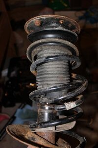

Well I finally got around to replacing the broken strut assembly on our '02 Sunfire this weekend. The car had been making an odd metal clunking sound for a little while now. I jacked the drivers side up and found that the spring had actually broken in half
This is what it looked like after I wrestled for an hour getting the bottom mounting bolts off the assembly
This is the original strut. Not bad considering it had 196k miles on it

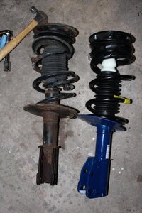

Old v's new:
I got 2 struts from rockauto, only got ot install one though. I really need to read directions when installing stuff .... I set the wrong torque when tightening the top mounting bolts and sheared one completely off the strut .... opps
I tightened the top mounting bolt to 33lbs when it was supposed to be 18lbs. First time using a torque wrench. Won't make that mistake again.
