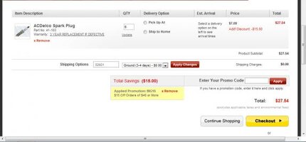

voymom said:
i found the thread and the plugs on rock auto, but i think i'm going to see the price for them at the parts store down the road first. It's $5 something a plug for individual purchase, so close to $35-$40 for 6 plugs compared to the $4 something for the pack of 8. Plus shipping of course, but i haven't ever used rock auto so i don't know if they include it or charge extra. We'll see. I will give a call to the parts place in the morning.
View attachment 19183 buy on line pick up at store plus $2 rebate on each plug
George said:
View attachment 4503 buy on line pick up at store plus $2 rebate on each plug
And what site is that??? I only have 2 auto parts store in my town
Car quest auto parts and OReilly's, other than that I would have to drive 30-60min one way to a different town, which I really can't do at this point because I am not allowed to drive due to surgical recovery.
I called Oreilly's and they want a little over $8.00 per plug :lipsrsealed:
