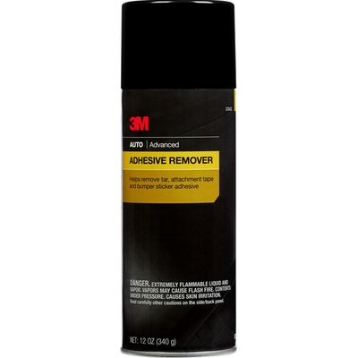

Heard that you can put some chemical on it and will start dissolving it without harming paint?
Rustoleum and 3M both make a decal adhesive remover in a rattle can. I have used the Rustoleum one myself when removing my lift gate LED bar, and some LED strips that used that double sided tape. Spray it on, let it sit for 5 minutes, and it softens the adhesive. I was able to use a plastic trim removal tool to scrape off the adhesive, no harm done to the paint. :twocents:

A vote for the 3M adhesive remover. I have used it with great success, when I removed my emblems.

I'm guessing most adhesive remover is the same. I used goof off when i took mine off, worked great.
