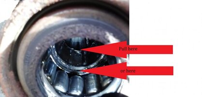

Where do I yank them from?
If i remember right, at the lower arrow.
The other thing is a oil "splash guard" kind of, dont know the right word for it.
Be sure to have both a torch and some freeze spray at hand, you will probably need it. I know i did.
Are the bearings bad, or are you just replacing them when you changing your leaking oil seals,,,just guessing:smile:
This is the donor SS axle I installed and the axles are bent. I don't want to chance the bearings being compromised.
Come to find out that's the ABS reluctor wheel and it doesn't seem that I can get the puller in between unless there's a trick.
Does the ABS ring need to come out? I don't need it since mine is an 02.
Does the ring get destroyed in the removal?
Yeah, that was interesting. No heat or freeze....just some expletives.
Well, I just laid into the slide hammer since I don't have any special tool that can grab the bearing leaving the ABS ring in there. I don't need the ring anyway so once I was about to give it a rest, I figured a good war cry with a few more hits should pop it out.
Yeah. :thumbsup:
