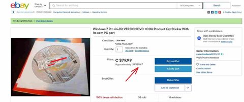

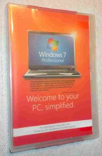

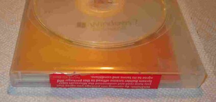

8,309
In support of the Pending PDF...and FWIW... I noticed there are STILL a few Legit Windows 7 OEM DVDs available on eBay with more offers from a Legit Canadian eBay Vendor I just dealt with. I snagged one for around $65.00... and discovered that it really DID come Shrink-Wrapped WITH the COA Sticker still Un-Attached, Un-Damaged and 'Un-Dispatched'. The DVD case was also still bearing the Red End Pre-Purchase Anti-Theft Seals. The W7PRO-OS Installed and runs PERFECTLY on one of my Dell Precision M4700 Work Station Laptops.
He probably only has a few more of these left by now via THIS Link:
CAVEAT EMPTOR (Buyer Beware): There are a LOT of Bogus Windows OS Disks being offered For Sale out there... So do your Due Diligence before Punching That Ticket. For example... I checked very closely that he had obscured the COA Sticker Product Numbers in the On-Line eBay Images he posted of the one I recently grabbed.
Here are some *Proof of Purchase* Images that also serve to show all of the right 'earmarks'...
