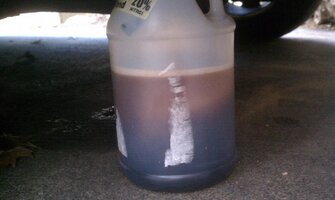

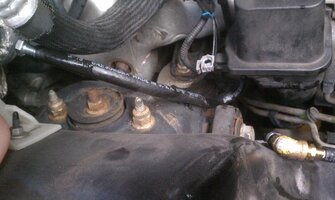

When I flushed mine I removed the airbox and washer tank, giving me alot of room. I connected a 5/16" ID hose to the low pressure port on the pump and raised it up and plugging it with a bolt to prvent draining. Then I used a 5/16 ID hose about 2' in length with a hose barb on each end of a brass 90 deg elbow, I connected this to the low pressure hose, there is a hole under the washer tank that will allow the hose to drain down to a container. If you cannot suck out the fluid from the resevoir it will make a small mess but I used a Mityvac and cleaned out the resevoir.
Fill the resevoir up and when you start the motor, start turning the wheel from lock to lock. The pump will drain the resevoir very fast so you should be able to turn the wheel from lock to lock before it gets tight, shut the motor off as soon as it gets tight. I used about 3 quarts to clean it out.....Sears sells the PS fluid in quart jugs which makes it more economical.
