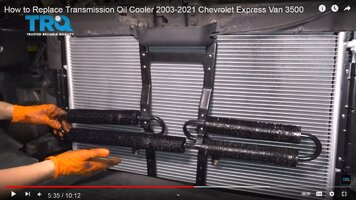

this OEM looks like a B&M super cooler weird it has bottom feeds. and yes what you say thats exactly what I read air being trapped causeing a potensional vapor lock.

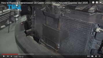

edit: strange looking trans coolerstrange after market cooler.jpg
which still gets heated fuild from rad.

The cooler in the first pic is the one I've seen the most, maybe smaller on 1500 trucks. The second pic I've never seen. Maybe those are on newer ones. Looks too clean.

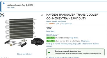

edit: the way that artical reads is missleading w/ bottom feed. it should read when both feed an return are on bottom. here's the usale cooler I opt for it's 26K have it on both 3500 an the 1500.
