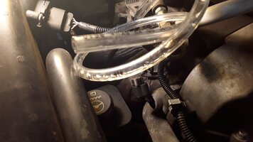

ADDED: I decided to try "measure" the vacuum at the dipstick... what a "dipstick"...
Anyway, I got a clear piece of tubing (~3/8od maybe) which fits directly into the dipstick. Put some oil in a glass bottle and inserted the tube into the oil. Started the engine and looked for the oil to move up the tube..... nada!!! :-( From this, it appears the vacuum is not very much... at least on my engine... disappointing.... BUT wait, when I removed the tube from the glass bottle, there was a slight amount of oil in the tube wall. I could see a slight "slurping" happening when ever the oil wall film filled enough of the inner diameter of the tube to "react" to a small bit of vacuuming coming from the engine / dipstick holder. Is this good enough? Don't know but in a regular PCV value situation, the "full amount" of vacuum has to pull on the weighted internal valve in a some "calibrated" fashion.... is it that small of vacuum "dribble"?
