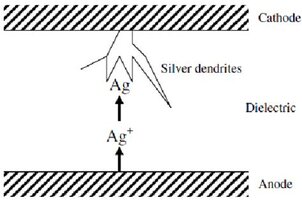

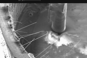

There may be one other issue:
Recently, issues with an IPC Draining a Battery due to having a Weird Phenomena occurring where the Non-Lead Solder causes "Tin Whiskers" to Grow and propagate all over the underside of the IPC Logic Board. If that situation was happening here... perhaps replacing the IPC with a Used one for a "Test Run" for a temporary comparison might reveal this as the Hidden Cause and Origin of the Problem:
THIS is what Non-Lead "Silver Migration" Looks Like:
